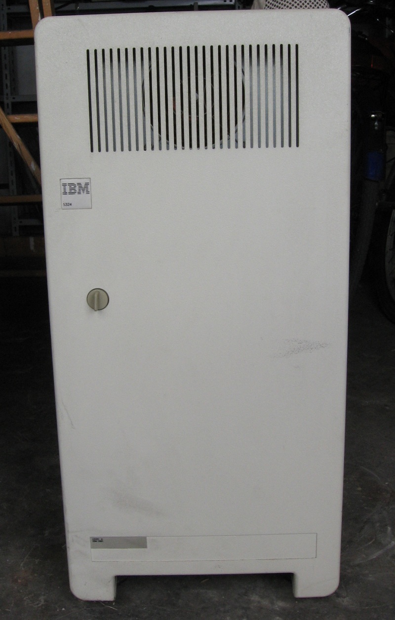

Error 35h - Unable to communicate with the keyboard
Check the wiring first, if not, your 8048 at the keyboard is done. I can help on that.
Error 3Dh - Unable to communicate with the 5247
Remove the communications card from the Datamaster and check if the error persist
Place the communications card and connect the 5247. If your 5247 is faulty remove the comms card so at least the Datamaster can continue operating.
I would advise dumping the ROM at the communications board - it hasn't been done yet and if the ROM fails even I won't be able to help.
