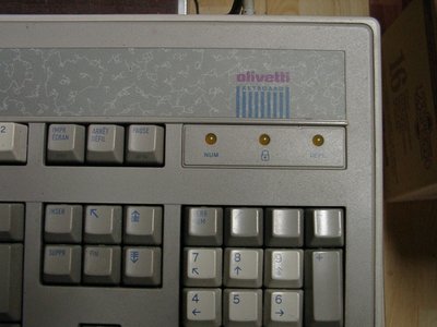

Hello! I'm have olivetti M280 computer.
(not my photo)

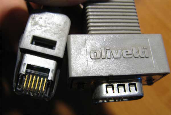

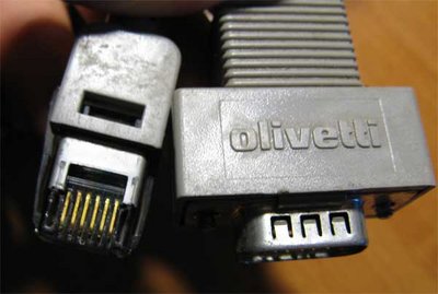

But i don't have special keyboard from this computer I'm only have this cable:
left connector to keyboard and right to PC.
Who knows how to convert this cable to standart AT keyboard? This cable, from olivetti, use only 5 contacts.
Please help! :wall:

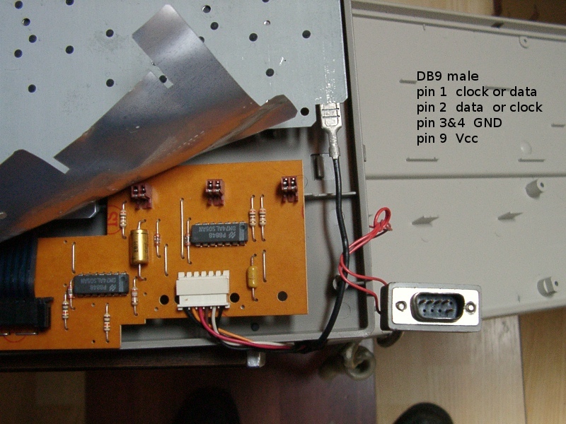

hello, bonjour
Câblage d'un ANK 25-102
